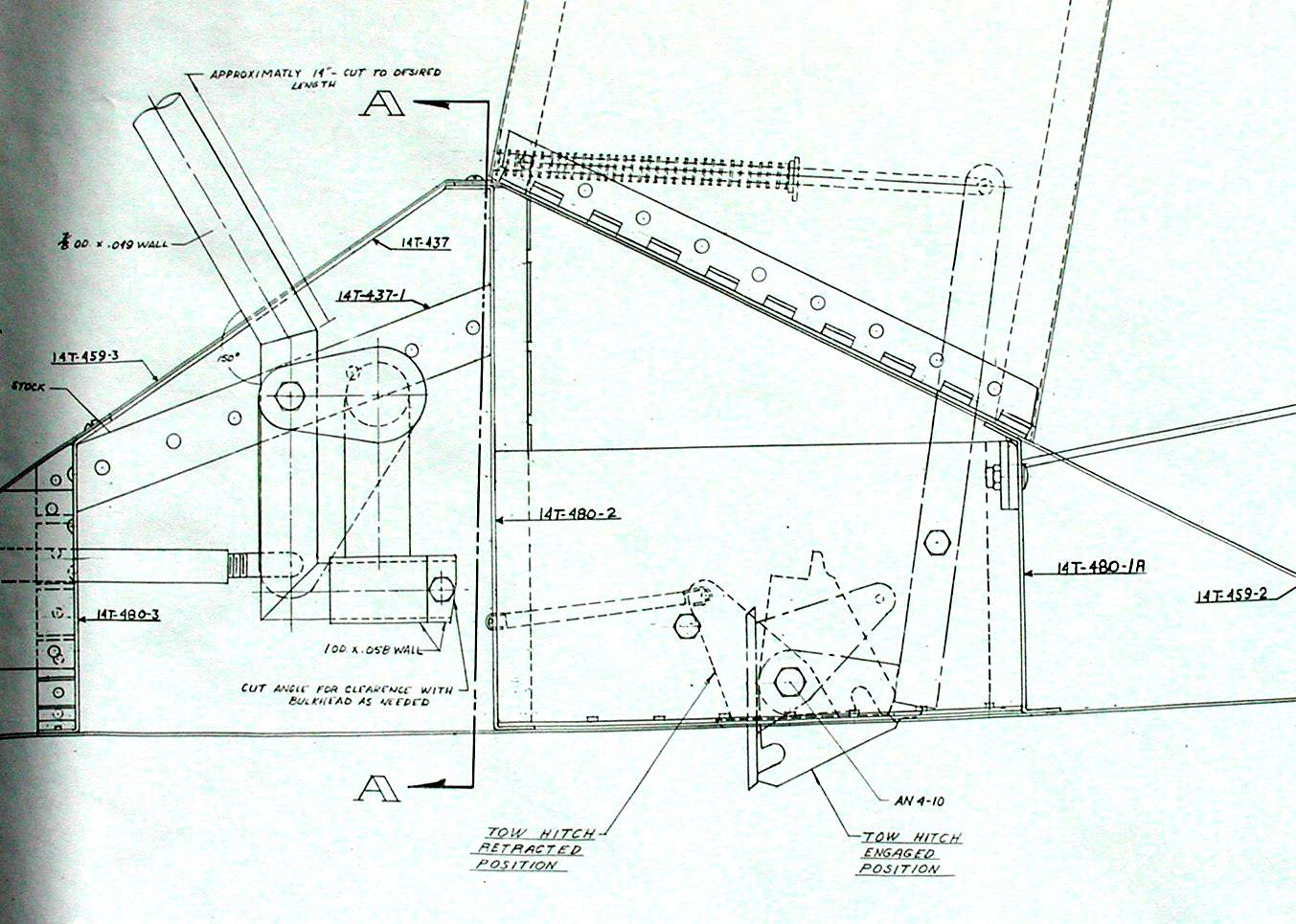

The glider's owner (not the pilot involved) told me that this release won't let go unless it's under tension. I'm not familiar with the design and wonder if that's a design defect or a defect in this particular piece of hardware. (Did 12 tows this morning and 2.3 hours in the LAK this afternoon!) "BobW" wrote in message ... On 6/1/2012 8:28 AM, Dan Marotta wrote: Snip... Later that day, an experienced pilot was flying his first flight in an HP-14. At 2,400' AGL we were indicating 1,100 fpm climb and said, "This is a nice thermal" on the radio. Seconds later the tow plane was jerked to the left and I looked over my right shoulder to see the glider at my 4 o'clock with a large loop of slack in the rope. I yelled, "Get off, get off, get off!!!" and, to my surprise, the response was the glider banking sharply into me and diving past my tail. Before I could grab the tow release, there was another sharp jerk and the rope broke. The glider pilot then enjoyed about 4 hours in the -14. Snip... Mercy! Tell me again what that in-glider release is for? My only self-induced rope break came on a BFR, demonstrating instructor-induced slack rope recoveries. (Due to lack of practice at slack rope after obtaining my license, I undoubtedly only got worse at it.) So I understand the desire to recover an out of position towing situation...just not at risk of life and limb. On another BFR the instructor bemused both of us as we watched the rope drift aft over the top of the G-103's wing until I could barely see the aft end of the loop from the front cockpit. It was one of the times I almost overrode an instructor's "My ship." In hindsight, we both agreed I probably should have. What WERE we thinking?!? Bob W. |

The glider's release mechanism is the standard Dick Schreder design.
http://www.soaridaho.com/Schreder/Co...k/Tow_Hook.htm Here is a photo of the mechanism as it appears in HP-14T blue-prints. http://www.soaridaho.com/Schreder/HP..._Tow_Hitch.jpg This hook has been very reliable for the past 50+ years. The concept has been copied and install on other sailplane designs including the 1-35A Wayne http://www.soaridaho.com/Schreder "150flivver" wrote in message ... On Tuesday, June 5, 2012 7:25:16 AM UTC-5, GARY BOGGS wrote: What size rope were you using? Was there an weak link? Boggs What type of release mechanism? |
On 6/5/2012 9:27 AM, Wayne Paul wrote:
The glider's release mechanism is the standard Dick Schreder design. http://www.soaridaho.com/Schreder/Co...k/Tow_Hook.htm Here is a photo of the mechanism as it appears in HP-14T blue-prints. http://www.soaridaho.com/Schreder/HP..._Tow_Hitch.jpg This hook has been very reliable for the past 50+ years. The concept has been copied and install on other sailplane designs including the 1-35A And also - at least conceptually/functionally - George Applebay's Zuni design (though some may now/have-had Tost releases); I can't speak for dimensionally/geometrically. Difficult (for me) to imagine a simpler release mechanism. I never had release a release problem in 106 HP-14 and 655 Zuni aerotows. Had 1-each back release in both ships, from BIG bows in the rope...as should have happened. Bob W. Wayne http://www.soaridaho.com/Schreder "150flivver" wrote in message ... Snip... What type of release mechanism? |
