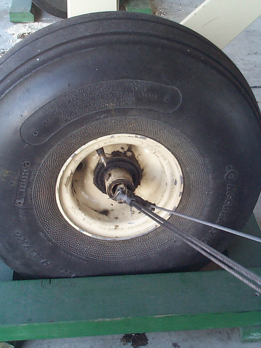

I need to add some shims to the axles of my Fly Baby to reduce the side-to-side
movement of my wheels (the axles aren't threaded at the end, the wheels are held
on with a cross-bolt through a bushing).
I basically need some thin metal washers with a 1.5" inside diameter. I'm
suspecting the "Ring-Grease Seal" items on Cleveland 600x6 wheels is what I'm
looking for. However, there are multiple part numbers for the same item
(153-00300, 153-00400, etc.). I'm suspecting these are differing
thickness...anybody got a table that shows the thickness by part number?

Check my description...there *is* no nut to tighten. The wheel slides on, then
a short piece of tubing (which I called a "bushing" but have been corrected to
term a "collar") slides onto the axle as a retainer. There's a cross-hole
drilled through the collar and axle, and an AN-3 bolt goes through to hold them.
There's no threads on the axle, and nothing to tighten. See:
http://www.bowersflybaby.com/wheel.jpg
I know you flybaby owners keep the air pressure in your tires on the
low side for some extra shock absorbency, but geeze Ron, isn't
that a bit excessive?
Frank Stutzman

On Mon, 26 Nov 2007 16:15:35 +0000 (UTC), Frank Stutzman
I hate long roll-outs... :-)
