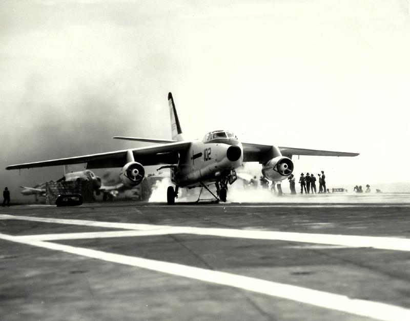

Back when I was MUCH younger I flew A3-B Skywarriors.
(http://www.soaridaho.com/Naval_Pictu..._12-Aug-64.jpg)
It had aerodynamically actuated slats. They slid in and out using rollers
on a track. When sitting on the deck gravity would cause them to extend.
At normal cruising flight speeds the air resistance would push them in.
They popped out at high angles of attack. The system worked pretty well;
however, heaven forbid that one of them got stuck in while the other
extended!

I think the A3 link is fixed and it should work .
extended!
snip
http://tinyurl.com/N990-6F
Wayne,
You may be interested, Whidbey Island Naval Air Station recently obtained an
A-3 and they're going to put it on a stick outside the main base with the
two A-6s.
Also the Seaplane Base has acquired a PBY and has it on display next to a
PBY museum. It's worth seeing just to see the technology that was the state
of the art in the 30's.

Rich,
Thank you for the update.
Several years ago during a VAH-10 reunion we tried to get the ball rolling
for placing an A-3 on a stick. After that I got a bit out of touch with the
progress. However, I sure hope that it is either a the bomber, or tanker
version and NOT one of the *******ized EW contraptions covered with all
kinds of antenna bubbles. (The EW things were based at Alameda, not
Whidbey.)
