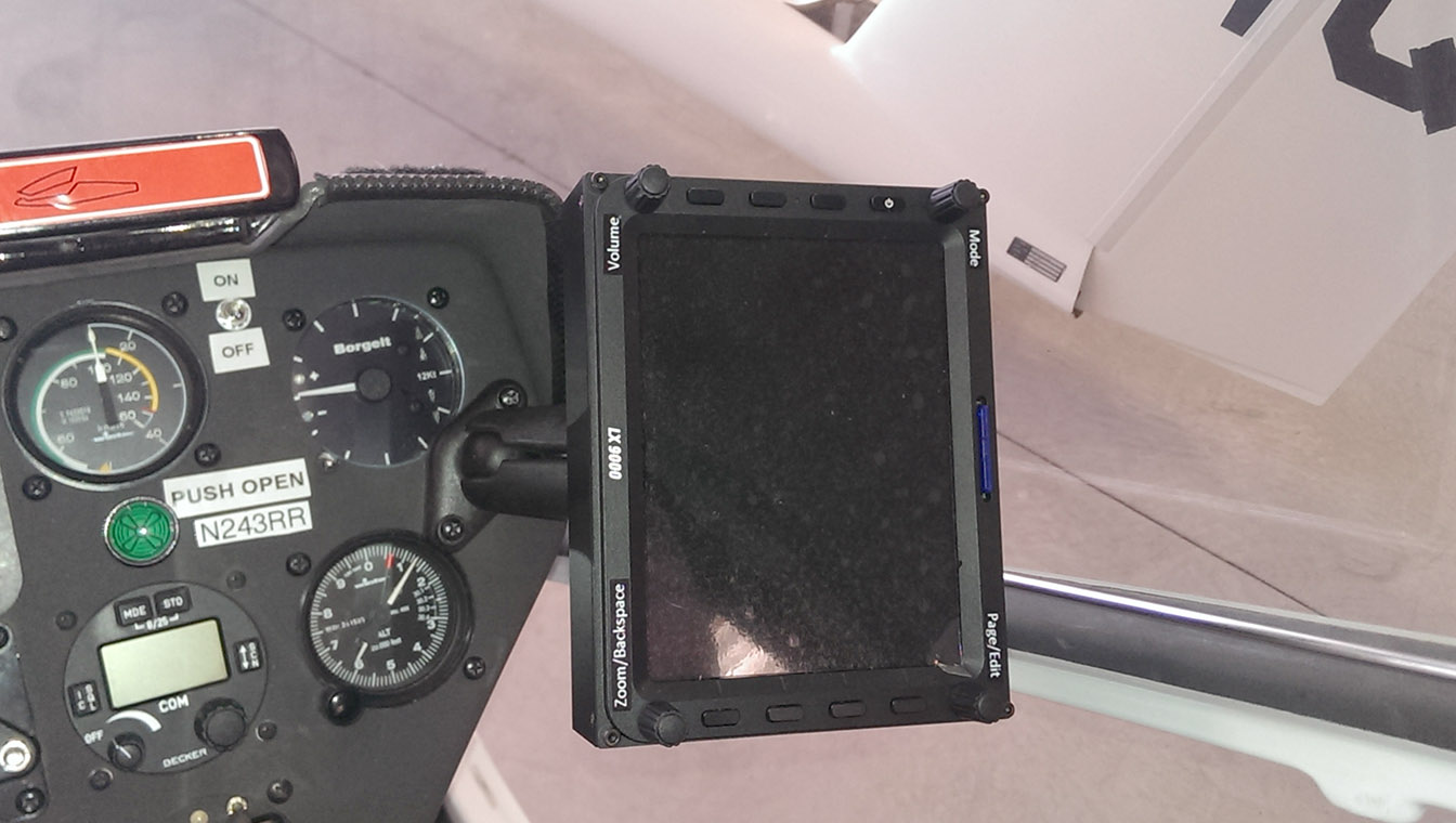

Indeed, Dan is correct..You can see my LX9000 on a RAM mount here...
http://www.cumulus-soaring.com/lxnav...AM-Renny-1.jpg
A RAM mount also supports my PowerFlarm. You can see that photo at this link. Please note that the Oudie 2 was replaced by the LX9000 in this older photo...
http://farm9.staticflickr.com/8381/8...5941fafc_o.jpg
