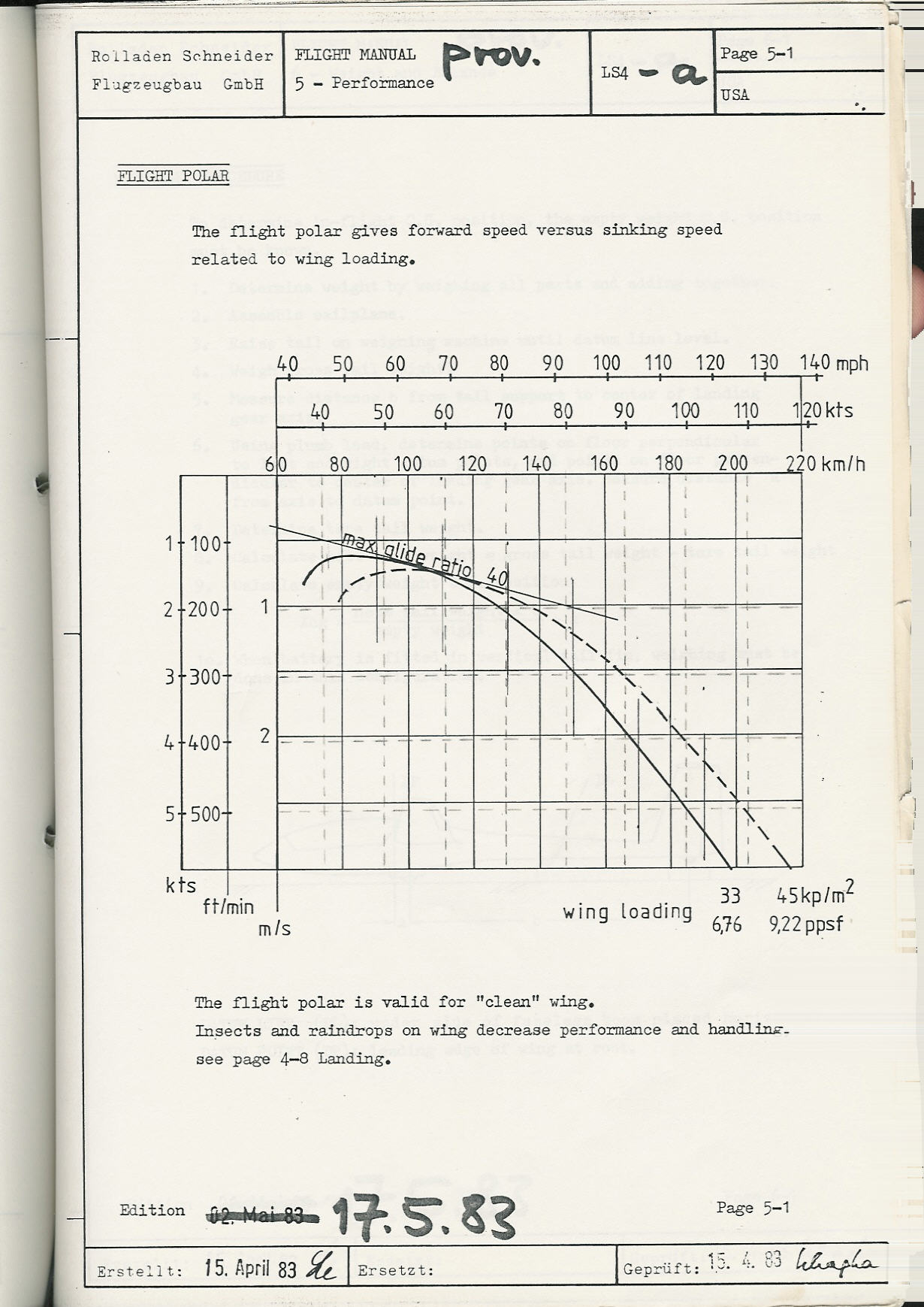

By comparison, there is a LS4 polar he
http://www.stolaf.edu/people/hansonr...lars/ls-4a.jpg
which gives L/D at 40. I think it is roughly equivalent to the Pegase.
