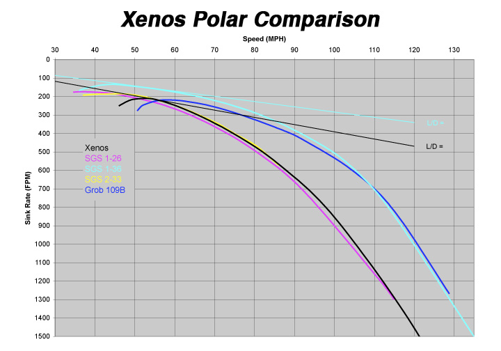

Sonex Xenos perhaps? I have no experience with it and am not sure what the
general consensus is (I doubt there is much informed opinion on them since
not too many have been built, so few would have first-hand experience; but
unless I am missing something their performance seems more than adequate
for training purposes.)
Upfront new: ~US$34,000 + ~1200 club man-hours to build.
Side-by-side seating: good for training?
Motorglider: Dispense with towplane costs.
Experimental: Lower part and labor costs.
Sonex provides directions on how to get it registered with the FAA as a
glider.
http://www.sonexaircraft.com/images/...Comparison.jpg
With a motorglider you do not "dispense with towplane costs" you
"replace towplane costs with motorglider costs" (and quite possibly
many more issues).
I would be surprised if a 24:1 (i.e. non-glider), homebuilt,
lightweight aluminum glider in a tail dragger configuration is meet
many of the practical needs of most glider clubs. I wonder what
getting insurance coverage for instruction on that would take.
