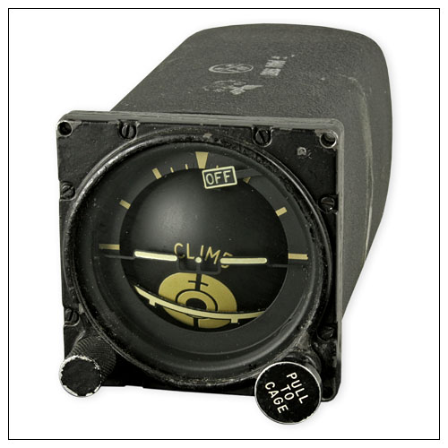

I've got one of these at the airport. Had it in a box for almost 40
years and it still works! Too bad I don't have the space, battery
power, or weight allowance to mount it...
http://www.aviation-dream.com/images...21_Horizon.jpg
http://www.aviation-dream.com/images/Alb_inst/130621_Horizon.jpg
